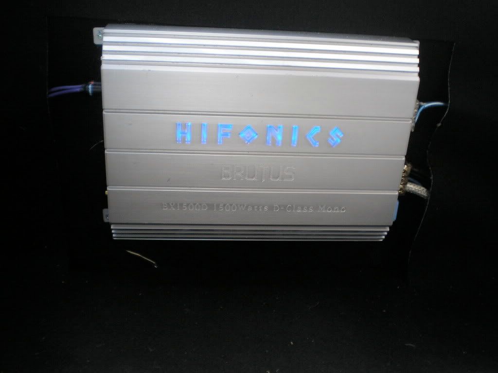

The motorized LCD came in today. I hooked it up to my testing system and everything is a-okay.
Oh, and heres the amp I will be using.

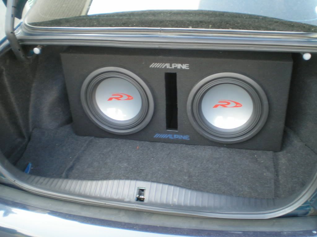

I finaly finished wireing up my amp. I had to run the power cable from the battery then under the car to a gasket seal where the wiring for the fuel tank wireharness is. Then pulled the cable and used zipties to hold the cable in place under the car. Then added a ring termnial to the end of the cable then hooked up the amp. Then I connected the wire to the + side of the battery and then to test it I hooked my iPod to it. The amp doesn't want to make a output frown. I played with it and blew the fuse then after fighting traffic and atempted to race a mustang on my way back I hooked up the new fuse and still nothing. Tomorrow afte wok i'll play with it some more. I think I might have some wireing messed up fo the speakers. I'll try hooking up my old AIWA speakers to see if they work.
Posted by: TCPMeta
Re: started once again on car pc - 02/21/07 03:55 AM
I sent a help ticket on bossaudio.com and they told me my setup isn't poweful enough to make a output or take my car to a audio place and have them look at it. Also the tech was picking fun at the idea of a mac in a car.
Posted by: Waragainstsleep
Re: started once again on car pc - 02/21/07 06:14 AM
Did you use decent quality power cable. Needs to good for amps or they don't play nice. You want stuff rated for 30A+ if memory serves.
Posted by: TCPMeta
Re: started once again on car pc - 02/21/07 06:42 PM
The manual says use 8gauge but I went ahead and got 4 gauge that I had left over from a grounding kit i made for my car. I also have a 50A+ bus fuse on the power cable and also the amp has a 15A+ bus fuse itself.
Come to find out I need atlest 60 watts going though the amp before it can kick on. So now im in need fo a preamp but a friend of mine that put a PC in his SUV keeps trying to get me to invest in a power accoustik 4 channel 960watt amp that has a built in preamp for iPod use. But that's another 110 bucks that I don't have. I don't know at the moment. I'll wait until next month and see if I can buy a bette amp or buy a preamp.

I have found out something odd for my car. I tested the amp with a old stereo speaker and it works! My neighbor use to work for Dodge and he came over and asked me what I was up too. I told him and he told me there are 3 stereo setups for my intrepid. Come to find out I had the high end setup that has a amp built into the car in the dash on the right side. Since the old stereo was pulled out the amp stop getting power and didn't let me use my speakers on the other amp I installed. Well instead of ripping apart my dash again I pulled out the back seat and found the old cable to the back speakers and cliped them and spliced them into my new speaker wire. My neighbor told me that Dodge uses any old wire they have laying around so the color code isn't the same. But the two speaker wires are braded together. Well there were 2 sets like that on each side of the car. I cliped both sets and did a trial and eror test and found the right ones then re-connected the other set. The other set of wires was my ABS and TCM for the rear wheels. So right now I have the rear speakers hooked up and they sound better then my old stereo. I tested this setup with my iPod.

Re: started once again on car pc - 02/22/07 04:57 PM
Congrats!!!! Lucky your neighbour came along... or you would have been out a bunch more $$$ and in the same spot if you got another amp!
Posted by: TCPMeta
Re: started once again on car pc - 02/22/07 06:11 PM
Yes yes, I was planning to run new cable from each speaker to the amp but this way was a lot easyer and faster due to feeding cables though a car door is like fitting a square into a circle.

I haven't bought new back speakers yet but im thinking to install a sub from a old stereo I had. It's small and doesn't sound bad with the type of music I listen too.
Re: started once again on car pc - 03/16/07 02:24 AM
I had a 600W, 12" sub in an enclosure in my car once. Ran it off a 500W amp. I'm told it could be heard for miles. I believe it too since the entire bodyshell vibrated when it was turned up.
Posted by: TCPMeta
Re: started once again on car pc - 03/16/07 04:12 AM
Well my amp puts 100watts to a channel and I have no idea how many watts my sub can hold. When I got my amp working the first time I had the speakers up all the way and it was so loud I had no time to turn it down so I just shut off the car. When I got out of the car I heard dogs around the neighborhood barking and neighbors coming outside to see what was going on. Of course this was around 10:30pm.
When my friend Kevin came over from Tampa he was impressed that the cheap-o amp was so loud and told me I should install a sub to pick up the lows since all I have two tweaters and two 3 ways going in the front.

No one has bought my gaming PC yet frown I got all of the speakers in the car working. I got my check from my 401K cashed before it was gone forever and now I have to buy two new front tires. What ever is left is going towards the mini. I might be cheap and get certified used tires. Oh, heres some pics of the sound system in the trunk.

My sound setup is just fine. although I need a stronger amp.
