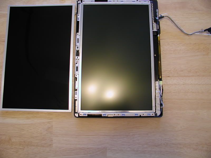

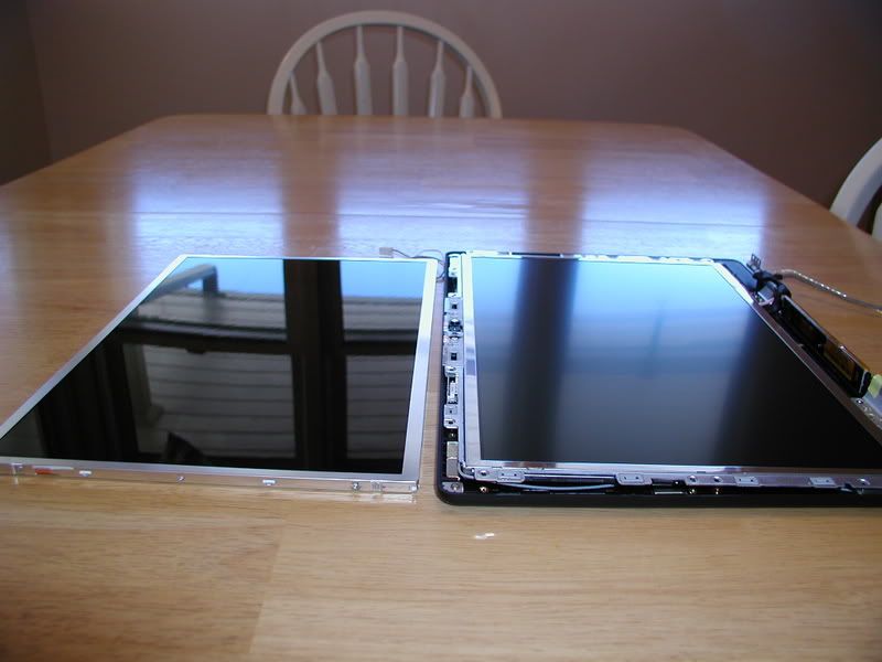

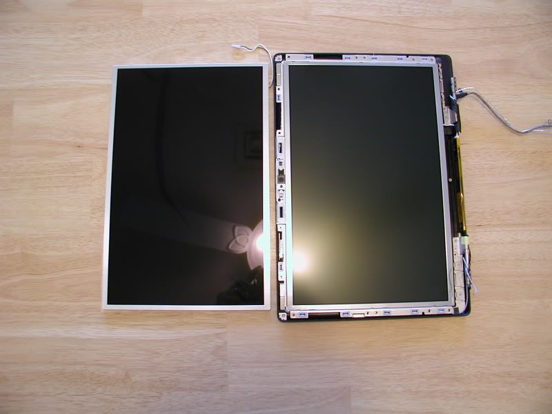

tried to take pictures that showed the difference in the panels. first shot was side by side with a reflection. 2-4 were taken with the ceiling fan/light on to show the difference in the screen finish. not a good camera, but you get the point.

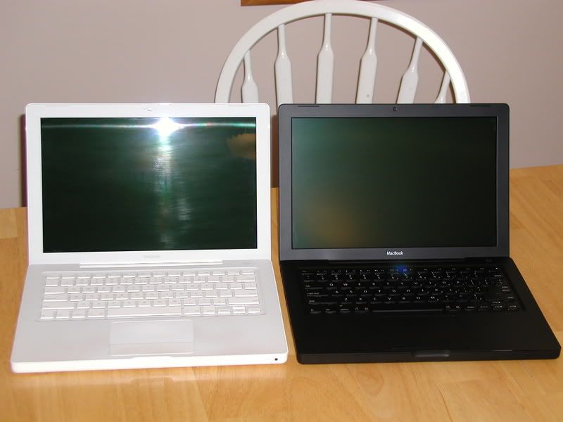

took a couple more with the macbook back together.
everything works the same. calibration, brightness control, photo booth flash, etc. seems very bright when side by side with a customers whitebook. overall, very happy with the results. the matte finish seems to match the finish of the blackbook better than the glossy. again, more details when i get them. peace out.
