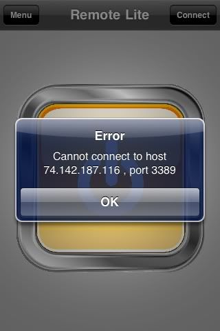

here's a pic of what it does.

Is that the IP address from the XP machine? That's an external IP address, like one that is handed out to a router. I forget, you do have a wireless router, right? What kind, or is the modem the router?

Yess, it's from the dell. And I do have a router. How can I get the touch to connect to it? I can control my touch from the Dell.
Re: Remote access - 01/27/10 03:28 AM
I don't see how the Dell has an outside IP address if you're behind a router. I don't know your setup.
What brand and model exactly is the router, you sure it's not just a switch?

Well the problem is you're going out on the internet then trying to come back in. The Insight router is handing out external IP's. Either the port on Dell's firewall must be opened, or the port on the router must be directed to the Dell. Unless you have a very secure password I would be careful of either. Since you can't even get to the router there's nothing I can do without knowing what kind. Then you'd have to know the password to get into it to forward the port to the Dell.
How do you connect with the Touch, is it an IP of 74.x.x.x? Don't post it, only the first set or two of digits.

Is it the IP in the image above? I can't ping it either. Don't post your IP in text format BTW, the picture was kind of okay. It's not a good idea to put it out in the open though.
