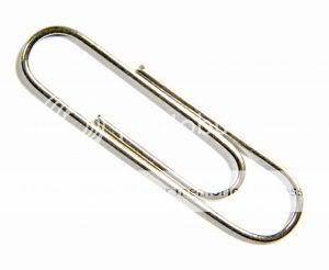

You have to stick a tech tool into the hole to manually pull the tray out first BTW.

Re: Replacement optical drive for PM G5 - 11/09/09 05:08 PM
Luckily I had my tech tool ready:
wink
I got it. At first I thought I saw glue on there, and I was going to be quite upset.
