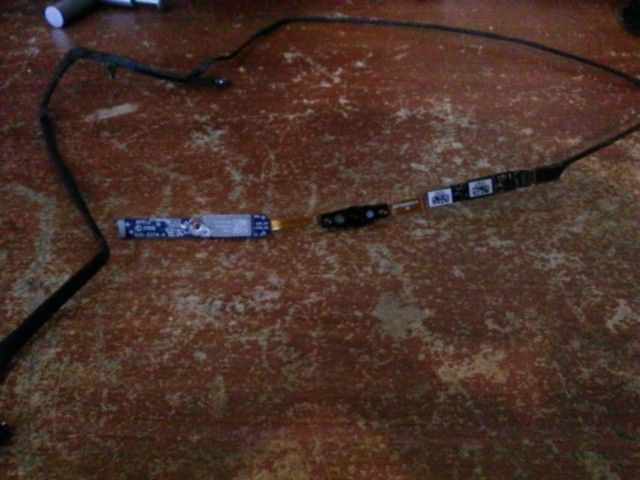

Camera with wire harness. The harness also connects to the WiFi/bluetooth module.

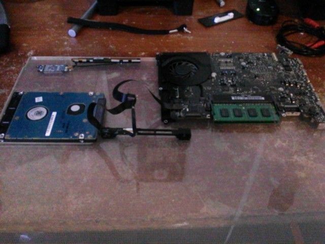

Motherboard to the MacBook.

Mock hardware layout. No need for a optical drive. Might hook up a second hard drive for more storage.

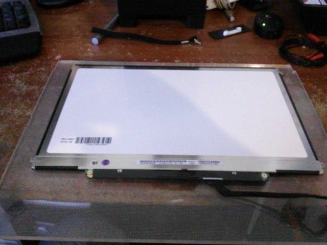

Mock LCD layout.

Ended up wet sanding the acrylic to get the stuff off. Came out well with 1000 and 1200 grit paper. I drilled and tapped the LCD mounts. Comes in handy to keep M3 machine screws around.
